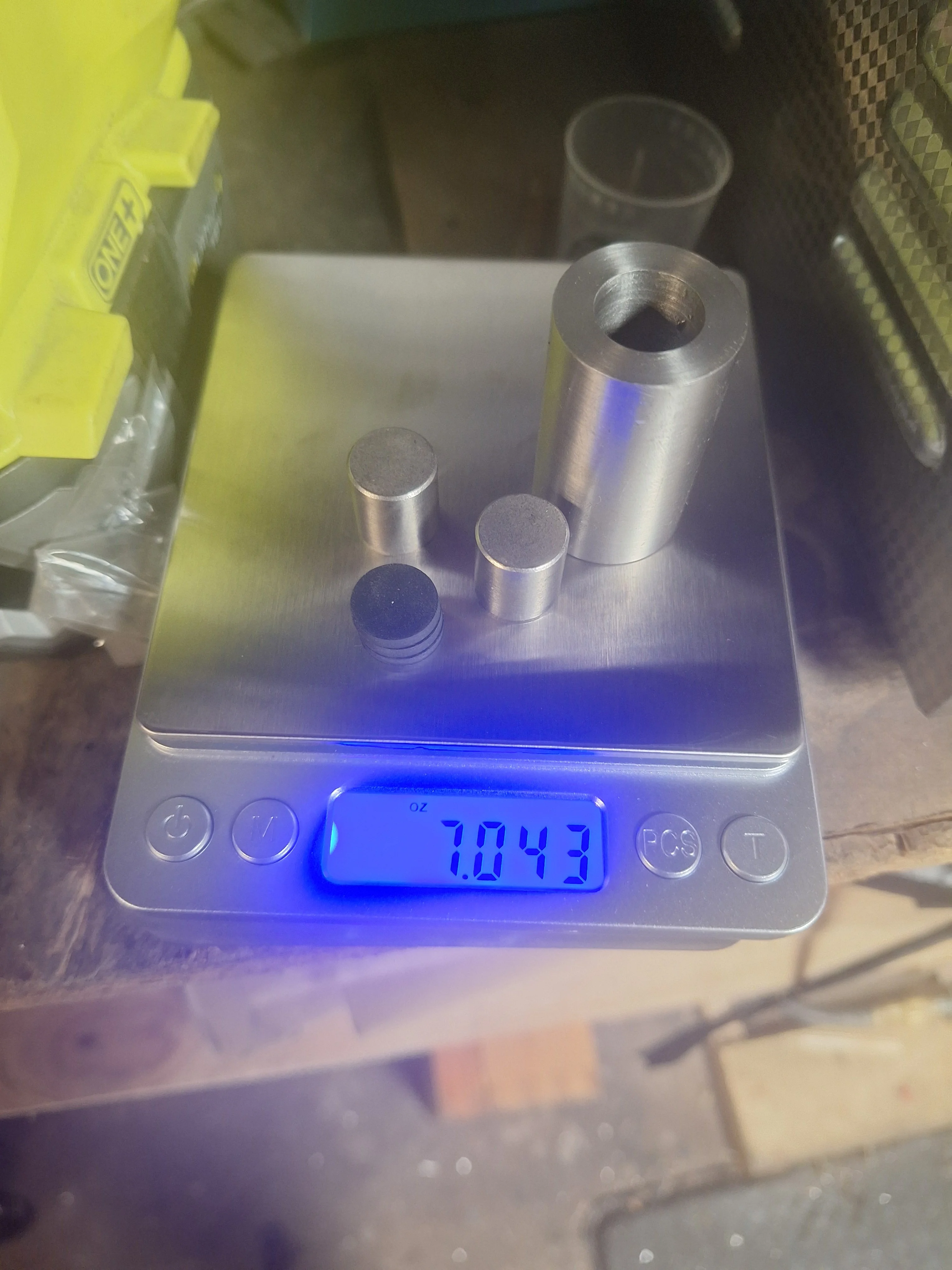

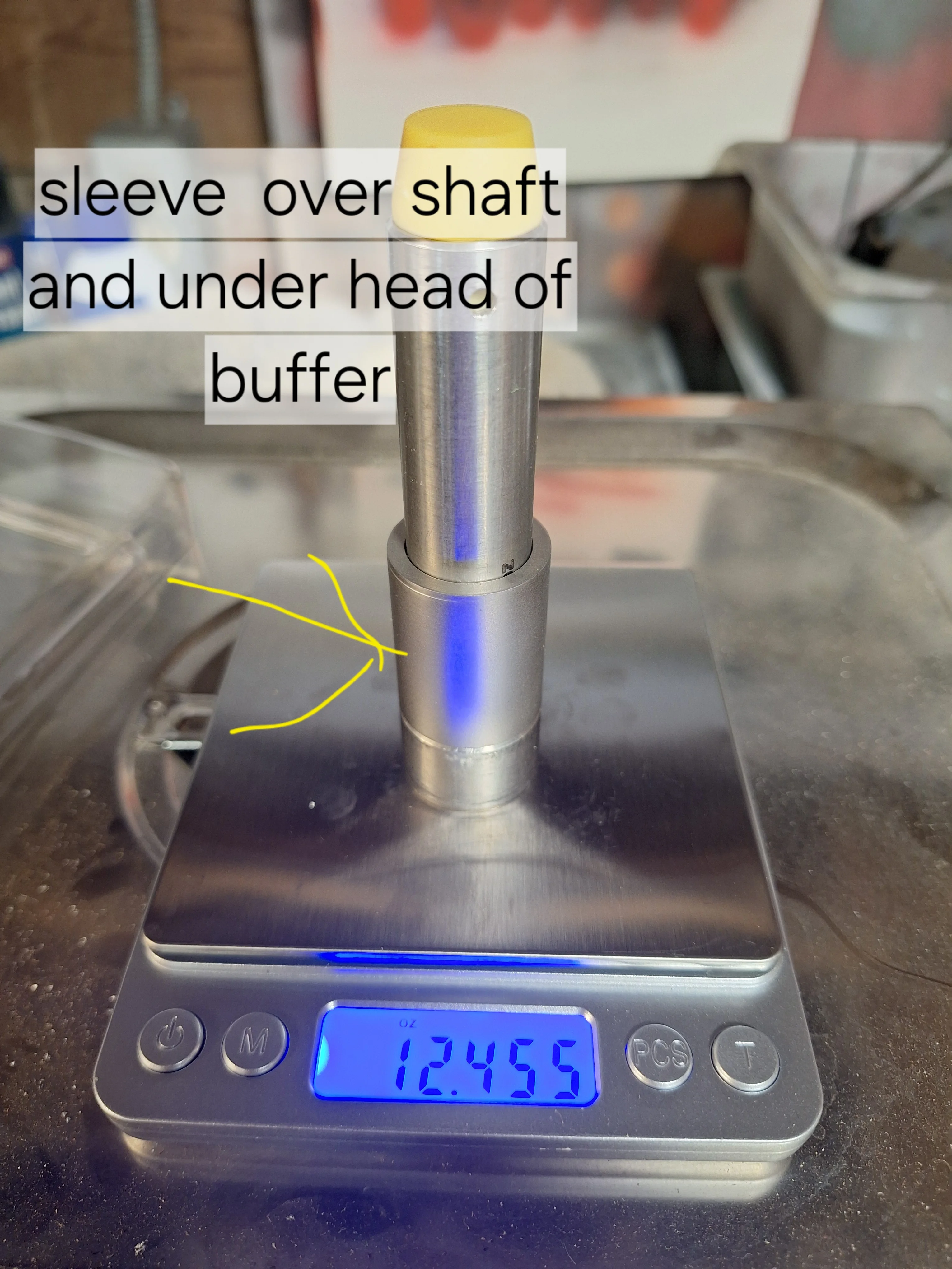

The problem turns out to be not enough bolt+buffer mass. 9mm needs 21 to 24 Oz reciprocating mass to function correctly; 10 mm is quite a bit hotter. Your P2A 10 mm bolt is 14.5 Oz and the buffer is 10 Oz. 24.5 Oz is not enough for 10 mm. You need 33 to 36 Oz reciprocating mass to tame the hotter 10 mm load. I had a friend machine me a spacer weight and a sleeve for the buffer to provide more spring compression to make up for the now longer buffer. I bought the 8.5" buffer tube from JR carbines to accommodate the 1.3" spacer and the Orange buffer spring from Springco. Now I have 33.6 Oz reciprocating mass and it has calmed down considerably. I am waiting for the tungsten bolt weight from KAK industries to come in and I will add that as well. I think it should come in around 35 Oz altogether. It still will cycle subsonic ammo as well as full power loads too.

The steel spacer is 1.63" and contains two 1.5 Oz tungsten weights. It adds 7 Oz altogether. The sleeve fits over the 10 oz buffer (so it does not add to the length of the buffer) and weighs another 2 oz. The buffer tube is from JR carbines and has standard buffer tube threads to fit on an AR lower. Altogether, the buffer + spacer is 5.63 " long. This all fits in the 8.5 inch buffer tube with enough room for the bolt to get behind the bolt catch about 1/8 inches so it will still hold the bolt open. The spring is from Sprinco. Go to their website. Their springs are color coded. The orange spring is their strongest spring and is designed for 308 caliber and ultra short buffers. The steel sleeve just provides another 1.3" spring compression to approximate the spring compression of the original setup with a 4 inch buffer and a 7 inch buffer tube.
